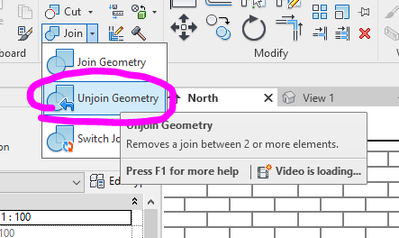

The problem you are having is:  The part of demolished wall created when you place a new window is blocking your new window.
You can use unjoin tool an click on the infill wall(demolished)/window to separate the infill wall(demolished) from the existing wall, then override graphic the infill wall to make it 100% transparent.
bin_1-1597273896492.pngT
You will be able to show the new windows with the demolish lines of the infill wall.
If you don't want to see the demolish line, simply skip the uncut and Tab select the infill wall to hide it.
