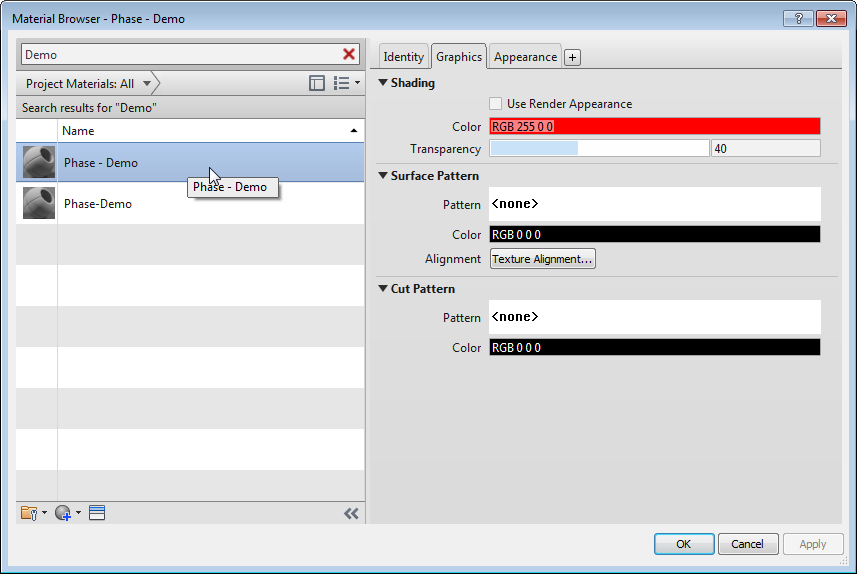

als Antwort auf: maan-L
I think I'm missing something here. The Phasing Graphic Overrides settings, that you are showing in your solution, have no effect on the demo shading in 3D.  You must have changed the Material color for "Phase-Demo".  Is that right?
I'm talking about this:
