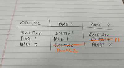

I am trying to create a room schedule that includes the Phase of a project as a field.
My central model has two linked files, Phase 1 and Phase 2:
this mapping makes sense for phase 2, i think:
But this doesn't seem like the right setup for phase 1.
Don't I need a future phase in the central model or somewhere for this to work correctly?
THanks!

Trying to finish this matrix, will clarify what is missing I think.Image.jpeg

For Phase 1 link you can set the link's Existing = Existing, and New Construction = both Phase 1 and Phase 2.  But for clarity, name the phases consistently for all links and host, and add phases so they align, even they will be empty.

So Phase 1 link should only have one construction phase (Phase 1)

It was a question but not worded well.
Is this what I am looking for?

No.
But I suggest adding Phase 2 to Phase 1 link and adding Phase 1 to Phase 2 link so everything align.
