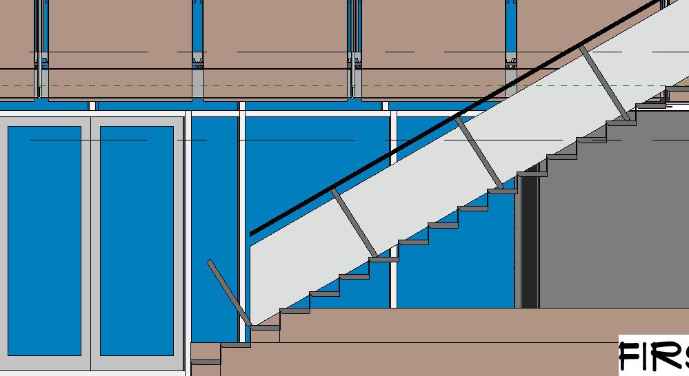

perpendicular panel and handrail on railing
how would i get my handrail (black) and my glass panel (light gray) to attach to the bottom perpendicular post (dark gray)?rev 1213.jpg

Baluster - perpendicular to the pitch line
https://www.youtube.com/watch?v=vsQBeAMAu04
....another excellent resource (Video and Handout). Bookmark it.
https://www.autodesk.com/autodesk-university/class/Designing-Custom-Railing-Panels-Revit-2017#handou...
