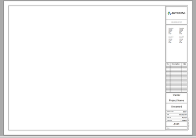

Hi.
Every time I print as PDF, I get some undesired margins something about the size of my selection grey square on the image, But I need the pdf to be the size of the sheet, in this case the external blue rectangle.
Cheers

Hi!
Did you use zoom 100% and center?
Or in 2022 version you can use export pdf use sheet size.

Hey.
If I set the zoom 100% I PDF a small portion of my sheet. so that wouldn't be it.

Which size is your sheet?

A1 - w. 841 x h. 594

If your titleblock is A1 then print 100%, no margin, to A1 page size.

I agree @ToanDN maybe Pablo has a titleblock with different size to A1.
this is in my computer with no zoom A1 title block
with zoom
If your title block is smaller you can calculate the percentage 200% 400%, if it's bigger for example A0 to A1 50%

Yes my Sheet is A1 size, but I believe that something is wrong with my my navigation bar - Zoom to fit, keep on zooming either very close to the sheet or very far.
But your answer seems the proper thing.
If you know how to fix that, please let me know.

If you want send us a copy of the titleblock to insert in my drawing and make the proof.
Also is a good practice revise that your revit is updated in the desktop app the hotfix update is vital for a good performance.
Also try with another PDF printer wich version are you using?
