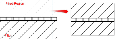

hope you are all doing great.
I have a problem with creating patterns with Filled Region and Filter.
I'm using the same pattern option in Filter and Filled Region with same color option (RGB:91,91,91),
but the pattern in Filled Region looks more faded. Does anyone have a solution to match these two patterns?

You can change the Line Weight of the Filled Region to match the same thickness.

Thank you for reply. It's working with the Filled Region lineweigh setting,
but do you know how I can change the lineweight of the pattern in Filter?

Depending on the category of your filter, you have the ability to modify the Line Weight settings within the Object Styles. In your case, use the Projection Line Weight

als Antwort auf: ralphdenhaan
Thank you.
But if I change the settings in Object Style, the lineweight of the boundary lines also change.
Can I change the lineweight of the pattern only??

In your filter change the Lines Line Weight to Override the Object Style:
I don't know if there is any other easier workaround for this.

This is perfect! Thank you so much :leicht_lächelndes_Gesicht:
