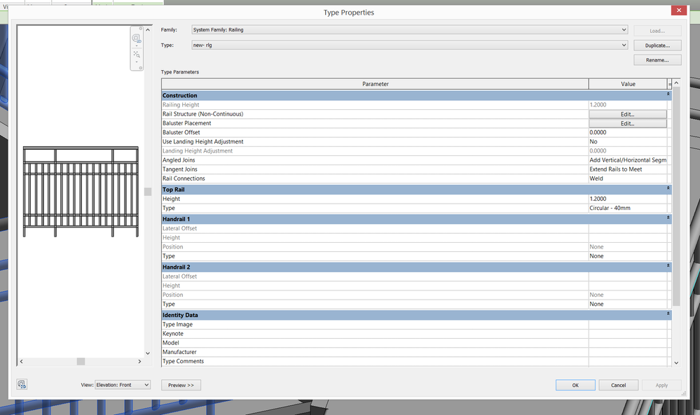

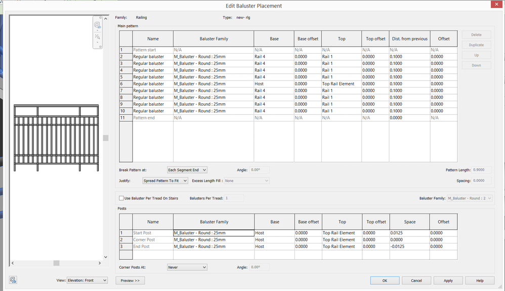

a blessed day to all,
hoping that you can help me about my problem in handrails in revit, i customized handrails and it seem it is look good but when i check it in 3d view, some of the parts are not connected, kindly see the attached file for your reference, i tried to edit all the parameters but it does not  work. hCapture1.PNGCapture2.PNGCapture3.PNGCapture.PNG

Add a small segment of horizontal rail after the slope before it turns the corner.
Nachricht 3 von 5
als Antwort auf: randiegarcia
Add a small segment of horizontal rail after the slope before it turns the corner.  Or raise the railing height at the landing a bit and have a post at that corner similar to the one right after it.

thank you very much! God bless you.
