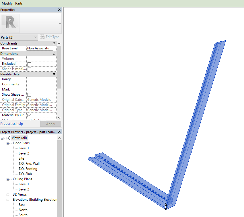

I am encountering an error message that I have never encountered before: "Parts could not be created from this family instance".
I don't understand why this is happening. So far I have never had any trouble to create parts from generic model families.
I need to divide this family into parts, in order to be able to isolate its individual elements.
Can you help me to find a solution? Project attached below.
Thanks in advance. JN

I'm no expert on parts, but could it be due to the fact this is modelled in-place and not a family?
When you created parts in the past, where this loaded families or also in-place components?

Get rid of those voids and Parts can be created.
