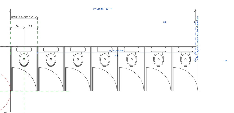

hello ,
I have a bathroom family that I want the cabin to have 0 distance once i pull from the arrow and have many more cabins. Right know I did the parameter to be 0 but once i pull it, It wont give me the right distance.
attaching the family.
2 ANTWORTEN 2
Nachricht 2 von 3
rxi.gg
als Antwort auf: BBV90
Your family has too much locks...
Hope this works for you. Find attached the family edited
