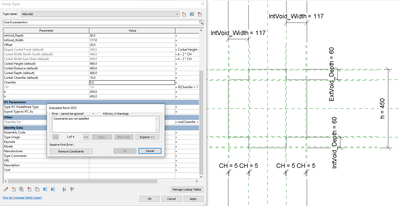

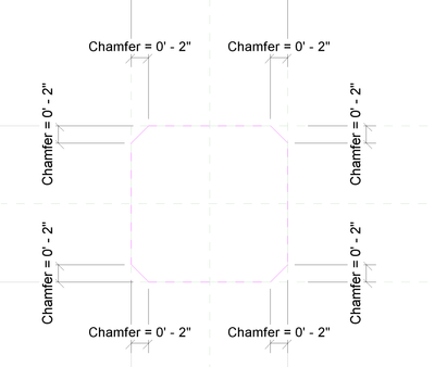

I am attempting to create a column family with side edge chamfers. I NEED the chamfer to be able to be set to 0. Normally this will not allow an extrusion to exist (giving the error of a line being too short - both with extrusion profile and voids), which is expected.
Revit has a default rectangular column family (I am attaching a copy of it) with chamfers that CAN be set to 0 without complaining. I have been using this family as a starting point, but cannot modify its extrusion profile reliably. The chamfer sketch lines seem to be somehow special - cannot be deleted or copied.
Does anyone know how these sketch lines are made? I am trying to achieve something like this (while being able to set the chamfer to 0:
Even if it is impossible, I would appreciate some explanation over those magical sketch lines that can be 0. I can't wrap my head around those.

Edit Extrusion and Align and Lock the TIPS of the angled line to both an x and y Ref. Plane.

Struggling a bit to make it work with the alignment. It keeps complaining when changing the value to 0. Any chance you can provide the modified family in Revit 2023 instead of 24? Thanks.

Use Void instead of sketch to get your chamfer to set as 0. See attached family for example.

If you load in the OOTB chamfer column and set it to 0, it will work.
This is how they set up

This is exactly the family I am using as a base line. But I cannot replicate the behaviour of these sketch lines if I try to create more corners or make a column from scratch. They seem to be, as suggested earlier, hard-wired, and I wonder how and why.
