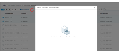

I always had my shared parameters in a local txt file and created them from within Revit. We now use ACC and it seems that also comes with a feature called "Shared Parameter Services" To me it looks like to allow an admin to create (or upload from txt) shared parameters and other users the use them, but can't edit them. Basically a BIM manager situation.
How well does that actually work in practice? What are some best practices? Is there any meaningful use of that if I'm the only one using those parameters? Do you still keep the txt files and create parameters in Revit the old way, or create them in the ACC parameter tool?
Some things I noticed:
After uploading, it indicates an error because my shared parameters don't have instance/type set. This doesn't make sense since in Revit you can't set that when creating a parameter. That gets set in the family the parameter is used in.
There also is a "Category"  where you select piping, electrical etc. that may be useful to sort the parameters and not just a a very long list. but existing parameters (imported from txt) can't be edited to get the designation.
There also doesn't seem to be a parameter group (a name I can make up, to sort parameters). So this may not as easy to use as the Revit parameter tool.

It seems I don't have the admin rights they talk about. So, I only can edit them out of the Revit feature. Now I'm also not sure if the shared parameters I uploaded (out of the Revit tool) would be accessible by others on our subscription.
And yes, the help is written for people who already know what to do with the feature.
And it is odd, that the shared parameters in the txt file (created by Revit) have the option to be grouped, but don't set the type/instance. but the Parameter Service parameters can set instance/type but can't group them.  They also seem to be able to get a category assigned. Since shared parameters have a unique ID, you'd think that would be exactly the same in DOCs and Revit.
I don't know if this is the case here, but sometimes Autodesk starts a new feature, but it doesn't really work for years. then they fix it, or abandon it. That makes me hesitate to invest time before it actually is usable and mature.
I made some mockup parameters in the Parameter Service. but I don't know how to get them into Revit or a family.
Helps says this:
Loading Parameters into Revit
When launching the service from Revit from a window where parameters can be added, select one or more parameters. After you select the desired parameters, select Add to Revit Model. You can use shift+click to select multiple parameters at once."  but there is no " Add to Revit Model"  option.
I'm also not able to delete the parameters i created in Parameter Service. It has the option to " remove parameters from collection", but it doesn't do it.
I think I stop using this unless I find out if it actually works.
