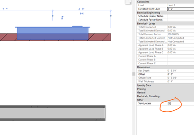

Could someone help me with the syntax for a formula?
I have a specific electrical panel I am building, it hosts fine, but I want to specify that it can not go past the inside face of structure.  I can't think of an instance where we haven't had 5/8" gyp on the inside of the wall but our exterior finishes and structure vary greatly. If I have an instance where my finish isn't very thick I want the panel to be flush with the inside of the structure and then the excess will poke out on the exterior face how ever far it needs to.
On the flip side if my wall finish is thick, or my structure is thick, I want the excess space behind the panel in the structure layer.i know we can use < or > in the formulas but I'm not sure how to word it.

What recesses exactly? Does the flange recess with box or does it stay flush with the wall surface?

Whoops, You need to change the wall thickness parameter to an instance (reporting).
I must have accidentally switched it off reporting.

@leahmbell wrote:
That is what I am after, but it breaks when the wall thickness is adjusted.
Try this family.  It breaks when you change the wall thickness in the family but it works in projects.  Untick Semi_recess box when you place the family and you can tick it on or off later.  If the host wall is thick enough for full recess and you tick Semi_recess then the panel will be deleted.  Pretty smart if you ask me.

@leahmbell wrote:
Perfect! That is what I was after.
Thank you!
Try this family instead.  I think it works in project without the need to check a box.  Don't change the wall thickness in the family though.
