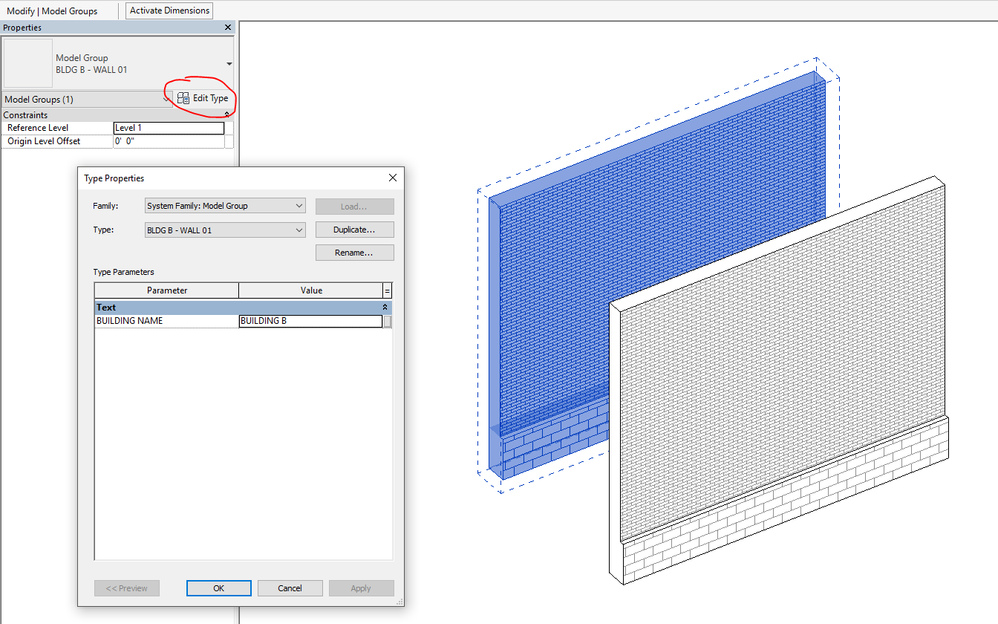

In a site, there are 6 buildings. We need to isolate the stacked walls for each building. Only building wise identification require.
Please consider the parameter name as "Building Name"
Thanks & Regards
BIMAbhi
Nachricht 7 von 17
als Antwort auf: BIMAbhi
If you use Revit 2018 then you can make model groups from the stacked walls for each building and add Building Name parameter via Mode Group schedule.

Here is workaround:
You can easilly add a shared/project parameter to a regular wall. Then you can assign any value its parameter as you want. Then just change regular wall's type into any type of stacked walls and you will see, that the parameter you assigned has left, but became inactive (read-only)
