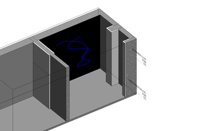

As you see down below, I applied (steel, carbon) paint "shown in black" to structural element, but in takeoff schedule its gives the whole wall area!. how to get the surface area only?

So you do not want to paint the entire Wall Face/Surface?
Use Split Face and paint only the area bounded by the Split Face.
