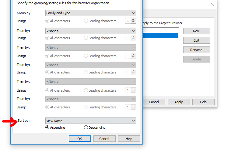

Does anyone have an idea why in this case the 1.3 Atrium SP is not being in the alphabetic order ? I spend some time trying to solve this and now I have no idea. All of these drawings are 3d views with almost the same parameters.

what version of Revit are you working in?

Revit 2018

Silly question, but do you have your sorting set up like this? (Wasn't in your screenshots)

Ha !!! Here you go I had it set up as a View Scale !
Thank you now everything sorts properly !
