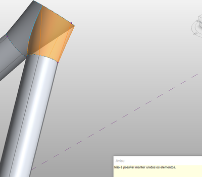

Hello!
I'm having a problem trying to model a bifurcation using mass families in Revit. Specifically in the part highlighted in red.
If anyone have a solution, can be using Dynamo or other ways of building this form, I'll be forever grateful.
Just to give a context, I work with projects of small hydroelectric dams, and this will be used in the conduct of a powerhouse.
Thanks!

What exactly is the problem you are having?
maybe attach the family too for an easier GIF or screencast

The ploblem I'm having is to join this formats. I'll attach a picture the problem that revit is showing me. I'll translate the problem: "It's not possible to keep the elements joined"
I'll need to upload this family into my model and use it as void to cut the concrete.
