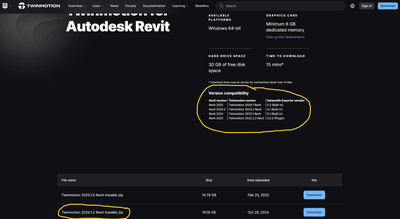

In the new version of Revit 2025, I have been trying to open files in Twinmotion to render but, on click "Open in Twinmotion" nothing happens. I am not sure what the issue is. In Revit 2024, I was easily able to open and work successfully.

I've noticed I've had to open Twinmotion on its own after an update before it would automatically open when selected in Revit. I haven't tried in R25 yet though. Holding off on jumping into that after all of the issues R24 had for months after launch.

Did you manage to fix this issue @spshalin23? I have the same problem, nothing happens when klicking on any TwinMotion options…

I did resolve the issue but I am not sure what resolved it. Either it got fixed after the Revit update or, I did downloaded the Twinmotion for Revit instead of downloading Twinmotion from Epic Games.
