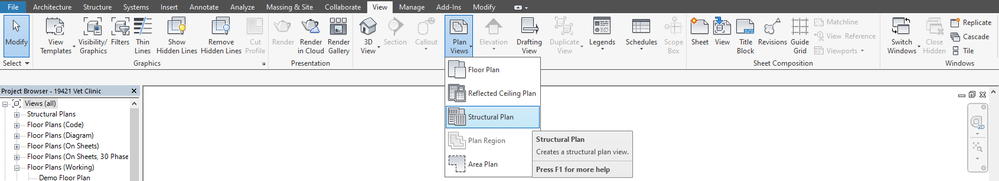

  2. To create a new structural plan, go to your View tab on the ribbon, then in the Create panel, click Plan Views and a drop-down menu will appear. Click "Structural Plan", and in the menu which pops up, select the level for which you want a structural plan view. You may need to uncheck "Do not duplicate existing views" at the bottom of the window for the level you want to appear. See the image below. (A curtain wall type has no relation to a structural plan view.)
How to create a new structural plan viewHow to create a new structural plan view

tuladhar.prerana
als Antwort auf: Redrunner92
Thank you so much for your help. It worked.
