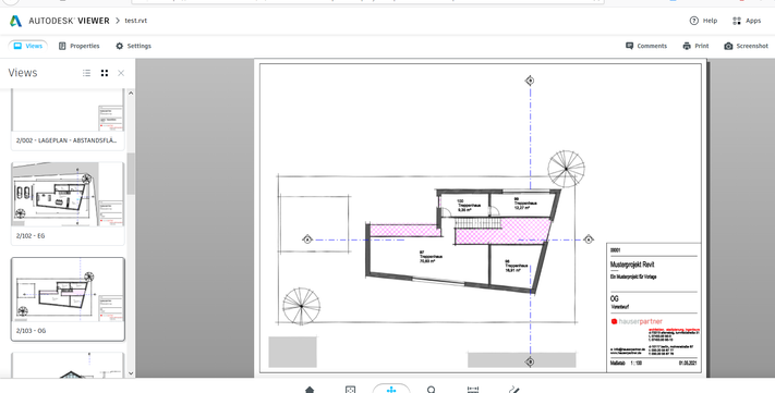

Online viewer shows project in grayscale?!!
1 ANTWORT 1
GELÖST
Nachricht 1 von 2
350 Aufrufe, 1 Antwort
I tried in the printing settings, but nothing changed. in the viewer on the side thumbnails it shows correctly..
1 ANTWORT 1
Nachricht 2 von 2
syman2000
als Antwort auf: Anonymous
In the printer setup, you have to set appearance to color. If you set it to greyscale or black and white, the online viewer will set it as such.
When I set it in color, it shows color.
