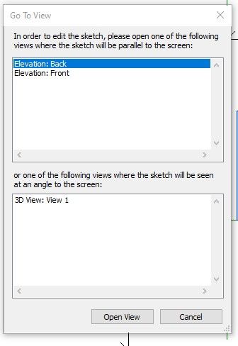

Now when I go back to the PLan View "Lower Ref. Level" I want to adjust the base of the column to match the bottom parameters.
The logical way for me to do that is to set the Work Plane back to the Floor Plan "Lower Ref. Level".
Then click the column and finally "EDIT EXTRUSION". But obviously that is not correct because again it tells me that in order to edit the sketch I must open a different view.
To me, it seems that Revit only allows me to edit my extrusion in the plane that it was originally created.
What am I doing wrong?

als Antwort auf: FSiedschlag
Yes, that's correct -- or a 3D View.
...So, I'm looking at your Family and it seems you have done a pretty good job here. Nothing is sticking out as being "wrong".  Where are you having difficulty?
