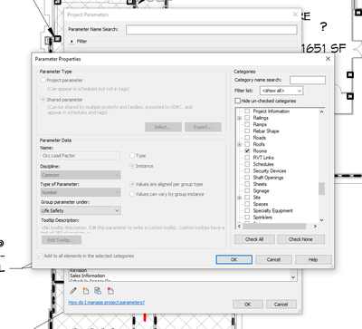

Duke_W
I tried to put the Occupant Loaf Factor parameter in the Rooms category, but I can't do that if it is a Type parameter.  The Rooms category only appears if it is an Instance parameter.
I wanted to make types in the tag family corresponding to load factor values, ie Business type = 150, Residential type = 200, etc.  But that isn't possible with an instance parameter, obviously.

The project is reading the Shared Parameters file.  That shot was taken from within the project.
Here it is in the project:
Message 23 of 35
mhiserZFHXS
It has to be an instance parameter.
Apply your occupancy type and load parameters to rooms as well, and have the tags read them. You can streamline this process by using a Key Schedule to assign loads to certain occupancy types.

It must be instance parameter assign to Rooms category (tick the box).  Use a key schedule to assign load to the parameters for consistency.  See example below:

I recreated the Occ Load Factor as an instance parameter in both the project and the tag family:
Project:
Family:
I will note that when you click on an instance of the tag in the project, there is no place to enter an Occ Load Factor value:
I'm still getting something wrong here, because this is what I get:
I'd like to leave aside the key schedule part for now, unless it is required.  I am on a time budget.

The rooms have the parameter. Select the room, put in your value, and it will display on the tag. Or you could click on the question mark on the tag, and it will let you type in a value there (assuming you've done everything correctly). But again, it adds that info to the room. Its not stored in the tag.
Tags are meant to display information from the tagged element. This is fundamental to their function. Works the same for doors, equipment, etc. You can add labels with formulas to the tag, but it has to pull info from its host for the variables in the formula.
Message 28 of 35
Your problem is that you are using the wrong "Occ Load Factor" Parameter. You have 2 types (in 2 different SP Text Files) - one is an Integer Parameter, and one is a Number Parameter. The Calculated Parameter Formula uses the Number Parameter. That's the one you need to pull into your Project as a Room Instance Parameter.
