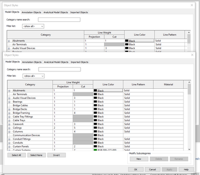

Why is it that this dialog box shows me all kinds of room over to the right but jams everything on the left? I can go expand it I know. The problem is I have to expand it EVERY time I open it. This is quite painful to have to work with when you go in and out of it often doing things like family creation or template creation. Frankly, it is just painful to have to expand those columns anytime.

What you show is not the default settings.  The Default settings are not collapsed all the way to one side, but spreading the entire window.  Revit will hold the entire window size and position, but not specific column widths.  See below for captures of the interface before and after reopen Revit.  At least, columns will not collapse like what you have.

I'm afraid that you are going to have to look locally for a solution as what you have is not the default layout.

Hello, I also find this frustrating - have tried deleting the UIState.dat file (Revit LT 2024) and restarting several times, and the Object Styles dialogue still opens with everything squashed to the left. Is there anything else I can try please?

It is not happening in RLT 2025. It may even be related with operating system and version, Win, Mac.
