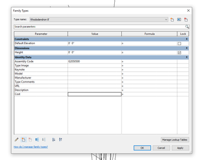

I am trying to look at the plantings in realistic mode, but they just disappear. I have narrowed down the problem to the render appearance not being set up, but render appearance does not even exist in my identity data.
Picture for Reference

The family doesn't seem to be using Tree/planting Template
  1. You can try using the existing plant template
  2. nest the 2D into the above family and change Rending to 3rd Party
  3. then use the added OOTB Render Appearance parameters to change the looks by selecting from Revits library of trees
If you want to continue using a family which is not generated from a planting.rft template, you will need to add a 3D geometry for rendering
or try out RPC creator.archvision.com you can also use that to create trees ... see how here 3D+ RPC Creator Tutorial - ArchVision

Open the Family and toggle Rendering Appearance Source to "Third Party".
