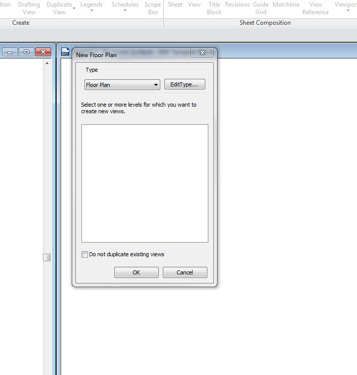

WMSlater
This is what I see when clicking to create a new floor plan. Again, there are no floor plans, sections, or elevation views in the project file - Just a ton of other families and custom settings.
Message 10 of 12
I don't know how you managed to delete every floor plan. I thought it wasn't even possible. Maybe create a new Template and transfer your standards over.
Message 11 of 12
WMSlater
If you try to delete the LAST level in a project, the program won't allow it, however if you select the last ones (multiple) like I did, then you can delete all of them. I must have done it in a rush to remove old datum levels.
