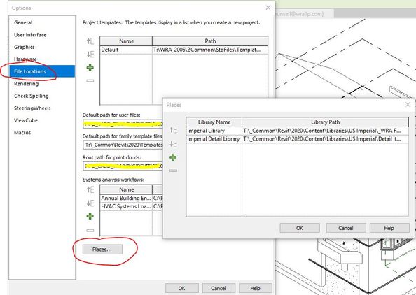

go to your Options > File Locations > Places...
what does it say?
can you shoe a screen capture of your File Locations and Places windows?
should look something like this (different folders of course....)
Howard Munsell

Notice my library path ends at libraries\Generic\ ..

for some reason my search path goes to this "generic"  folder and not to C:\ProgramData\Autodesk\RVT 2020\Libraries\US Metric

So change the path.  All fixed then. No?

stop pointing tot he Generic folder, what is in the next folder up?  neither of those should be pointing to the Generic folder. try pointing it to .../RLT 2020/Library/ or .../RLT 2020/Library/Metric Library/
