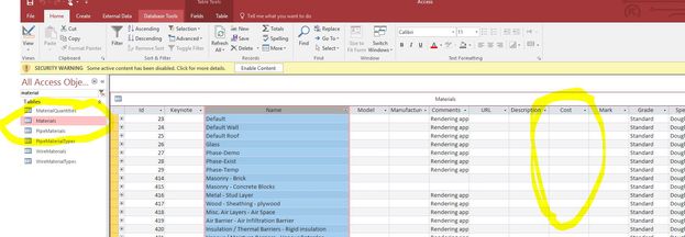

Have you tried creating material takeoffs and adding the cost and any other formula into the actual schedule table itself?
http://www.graitec.co.uk/blog/entry/how-to-filter-a-schedule-in-autodesk-revit
you can then filter the schedule based o whether the material is part of the object e.g. brick in a wall, or applied post build e.g. paint or tiles.
the schedule table can have multiple formula added to apply sums sum as working out the number of bricks in a wall e.g. Wall Area*55 and you could even add on wastage % etc.
Regards
Justin
PS once you have a schedule, then this can be exported out to an Excel Spreadsheet  or ODBC into MS Access. Here you can alter information such as cost and manufacture details, save and then 'push' back into Revit (it's a bi-directional link). The DBLink is an Autodesk add-on and is free.
If you're looking for a similar solution via Excel, then Graitec have a whole series of tools including this in their Graitec Revit Power Pack
