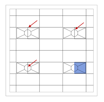

I've noticed a couple of problems when placing new lights in the same spot as a previous light that has been demolished.
The main problem is that face-hosted lights won't cut through or hide in any way the infill panels leftover from a demolished light.  It would seem to me that like doors and windows in walls, when an element is demolished and a new element is put into its same location, it should cut through the infill panels as well as the host wall. This does not seem to be the case with ceilings as shown in the screenshots below. If I host the light to the infill panel, it will cut through it, but if the light cuts through the entire infill panel, I'll get the "can't cut instance out of its host" error. It's silly that I would have to nudge this light over a fraction of an inch to get the drawing to look correct.
I understand and have seen how the architectural ceiling-hosted lights do not behave in the same way. However, our firm insists on using face-hosted lights for their better usability to our engineers when they copy-monitor them. Regardless, I don't understand why the face-hosted lights would behave differently in this regard. Is this a bug? Is it intentional?
For now I'm "fixing" the problem by moving the infill panels to a hidden workset, but I don't think I should have to do that, the new lights should just cut the infill panels, right? Has anyone else seen this problem and have a better workaround?
Everything was tested in a new Revit project with no template and OTB light fixtures.
Existing view - lights are to be demolishedExisting view - lights are to be demolishedNew construction view - can see and select the infill panel through the new lightNew construction view - can see and select the infill panel through the new light
Second is a minor graphical problem-- when placing new lights in a model pattern ACT ceiling, the pattern lines at the edges of the light don't show correctly in the existing view (and vice versa.)  The good news is that the drawing will still print correctly, but it's still bothersome to see in the view. Hardware acceleration on/off has no effect.
Existing view - ACT grid lines don't show around new lightsExisting view - ACT grid lines don't show around new lightsNew construction view - shows lightsNew construction view - shows lights

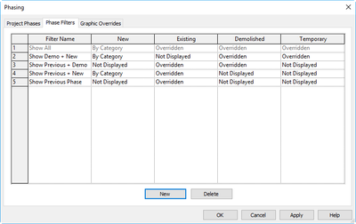

Interesting. I can't replicate your issue. I'd ask you for a sample file, but it looks pretty straight-forward: 2X4 ACT System constructed in "Existing" Phase with Phase Demolished set to "None". 2X2 Troffer lights constructed in "Existing" Phase with Phase Demolished set to "New Construction". 2X4 Troffer Lights constructed in "New Construction" Phase with Phase Demolished set to "None".
...I'm wondering if it's related to Phase Filter settings. How do you have those set up?
Nachricht 3 von 11
als Antwort auf: barthbradley
Phase filters and overrides below.  I've attached the project I've been testing in as well. In that file, I have a box on the left that uses the face-hosted lights (where the problem is happening) and on the right is the same box but using architectural ceiling-hosted lights.
