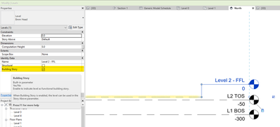

3 main levels per Building Story
  • Finish FLoor Level (Set as Building Story)
  • Top of Structural Slab (not Building Story)
  • Bottom of Structural Slab (not Building Story)
Do you only have like 3 levels.
Basement, Ground floor and first floor, and when you create a ceiling,  then you make an offset from the level or do you create a ceiling level. Like an associated level or new one.
You do not need a level Datum for ceilings/suspended ceiling. you can create Ceiling Plans from the Finish Floor Level Looking UP
  • Remember: Adding too many unnecessary levels may mess up the visibility and graphics of plan views and mess up quantification
Im using a wall for structual foundation, when I need to adjust the depth of the foundation, I think its easier to adjust the level, insted of the selecting all the walls and adjust the offset.
An infinite NO!! Once you set the levels up you do not change them just for the sake of increasing depth or height. That will mess things up for everyone else. Use one of the following
  • Either Top/Base Offsets (You can associate these to global parameters)
  • Or Attach base/Top of the wall to a reference Planes  (then you could adjust the walls via the reference planes)
