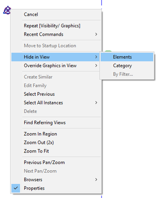

mpeperkamp
als Antwort auf: Anonymous
Hi Trinh,
You can hide the object on your floorplan.
Give a right click on the object, select hide in view., and then by elements.
Best regards,
Michiel Peperkamp
Cadac Group AEC
Cadac Group
Platinum Partner
Nachricht 7 von 8
als Antwort auf: mpeperkamp
I couldn't select the symbol, so I couldn't hide it. Since it's not printed, so it's good for me now. Thank you guys for the help.
