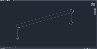

I'm trying to load a nested void array on a parent family which contains a sweep . The nested void array (holes) cut perfectly onto the sweep, and I can adjust the elevation without any errors. But I can't seem to make the nested void array increase and decrease as I adjust the length of my sweep. And also, creating a nested single-hole family and arraying it inside the parent family is just a constrain nightmare so don't even bother trying to do that.

When you doing array, you want to use array end. Afterward you use formula HoleArrayLength/6" to get the number of holes in between. What I did is multiple nested family to make the array works. However array need to a start and and end. When I build the family, I tend to go with origin point as my start point and then go with whatever length in X direction.
I recreate the family with Revit 2022 so you can see what I did in the family.

THANK YOU SO MUCH!!
