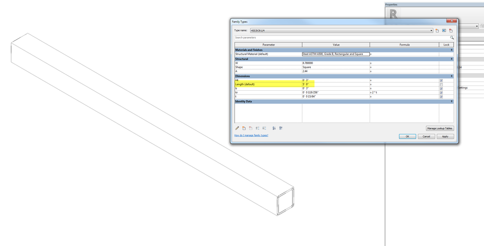

The HSS member family doesn't have length within the properties. It's listed as Length (default) in the family types when I open the family itself like below,

Constrain them using reference planes, not associating parameters.
Nachricht 5 von 9
Sahay_R
als Antwort auf: Anonymous
@ToanDN - the ends of the HSS don't lock to both reference planes - just jumps from one to the other.
HSS - are line based families, which means you  need to click at each end to place them. As a matter of fact, all Structural Framing families are line based. That is why their Length cannot be associated to a host family.
Try nesting some other family, or creating extrusions that can be locked to the reference planes.

Have you tried what I suggested?  See screen cast, it should work with any OOTB structural member family.
https://knowledge.autodesk.com/community/screencast/79cadb66-eb23-4756-963b-7c4e75f3948b
Nachricht 7 von 9
Sahay_R
als Antwort auf: ToanDN
Aahh! You nested the HSS into a generic model family, instead of a structural one. Nice!
