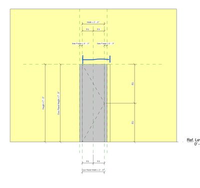

Hi all, I am learning a revit.
I am creating a door family with multiple door type with it. So you can switch the door type in the project.
The issue that I am having is, I created a door as a generic model and switch to the door category with shared. and load it into a door family with frame and all the door relate parameters.
 Just a door only and added dimensions as shared parameter.
 And I tried to link the opening and door panel so I can control with one parameter. But I made it work with height without any problem but width doesn't work right.
I have 3" frame both side of the door panel and constrain it together, byt the dimension of door panel seems fine but the actual model seems off a little bit.
Does anyone can share some wisdoms?
