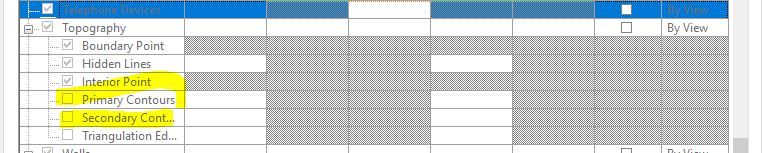

1. Am not sure whether this will help, but in Topography you can control the Countours line visibility..
2. You may need to use Plan Region to Capture the Floor plan the way you want. For ex : to capture some element above cut plane
plan region can customise cut plant for specific area..
Hope that of some use..
