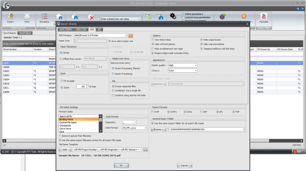

It is obviously possible, as RVT Xporter provides the function to create a bespoke export file name using your project parameters.
Could we please request that Autodesk add this to Revit 2017 asap to the export function?
