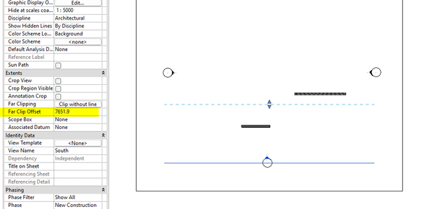

I need some help. I am drawing a building in Revit. But the building is just showing in East and South elevations, and not in North and West.
Does anyone have a clue why this is happening? And is there possible to fix it?
I have zoomed out to see if the drawing is elsewhere, but i cant see it.

Have you checked the far clip offset?
If you select the elevation you see a solid line and a dashed line.
The solid line indicates the strat point of the view. The dashed line indicates how far the view will look
In this case only the first wall will be visble in my elevation.
If I want to see  both walls I have to extend the farclip so that it includes the second wall. This can be done by dragging the triangles or increasing the distance in the far clip offset parameter
If i want to see only the second wall I have to move the solid line past the first wall and make sure that the second wall is in the area between the solid and dash line.

Could also be that the View is showing the wrong Phase. Check the View's Phase.
