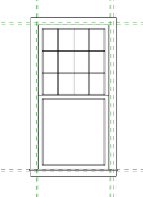

I may have misworded what I was trying to ask, I was trying to ask if there is some kind of conditional formatting statement that lets you create a formula with more than if true or false.
I was able to figure it out. I nested the first two family type selector options, then in the main family created a separate set of family type selector options.
Long story sort of short, I'm creating a window family that has the option to be anywhere from a single window to any number of connected units. The challenge I was running into was how to drive the number of vertical dividers, I needed 3 options. Option 1 would be 0 of them in the case of a single window, Option 2 would be 1 of them, when you have a double window, Option 3 would cover any greater number of windows via an array. I ended up creating two types of the divider family within the multiple window unit family, used a family type selector parameter to cover Options 2 and 3, then loaded that into my main family that includes a single window unit and the multiple unit. I then created a family type selector parameter in that main family to choose when I wanted to see the single window vs the multiple window, this covered Option 1, when I needed no vertical dividers.
I can post the family once I'm done vetting it, it's actually pretty cool.

I'm trying to automate these choices so the end user only has to select the number of window units, and everything else will be formula driven..
