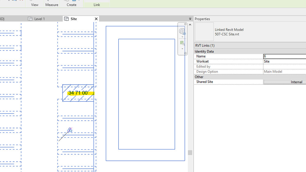

Keynotes in a linked model show correctly if i set the link to By Linked view.  Link model and Host model are using different keynote database files.  Not sure what is going on at your end.

If you use one database file for all the models then you can key the linked elements directly in the host model.  The key note will pull the elements' information from the link so if you want to make any changes, you have to open the link to change, which is understandable.  That way you can include the keynotes in the legend.  I did not test but you may be able to copy paste the site keynotes from one building to another.
The screenshot below shows the parking as an element from a link, but the keynote and the legend are local.

You are correct.  Filter the linked keynotes By Sheet must be the reason they showing blank in the host even with By Linked View selected.
