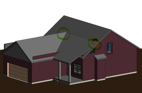

Wanting to know the best way to tackle this roof. Can this be done using one roof?
Please see the original drawings for the roof:
The elevations keep getting flipped upside down regardless of any attempt to fix.
 What I've got so far:

The main issue I am having is the different sloped roof over the front right of the house. However, this slope does not continue all the way across, so I'm not sure how roof by extrusion would create this.
The roof above the front porch is about a 5.5/12, where as the main roof of the house which is also on the left side of the house is a 10/12.

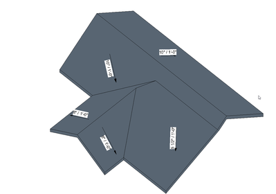

syman2000
I would extend the 8/12 and 5.5/12 roof over to the main roof. Then do join geometry so you get the outline. After that you edit the main roof profile and then you pick the edge where the lower roof meet.

constantin.stroescu
I'd use :
  • a Roof by Footprint with Cut Off made at the level of the lower Roof ridge height
  • and the second Roof by Footprint on Top of the first one with the same slope as the bigger slope of it..
  • Finally Join the two roofs..

no shape editing necessary.
...but you can use alittle bit of everything one this one.   Defined Slopes, Roof by Extrusion, Slope Arrows.  Fun.

FWIW @BigPicture045 :
Shaped Edited using 3 Split Lines:
...if you have full Revit.

Of course.  One roof by defined slopes.  No roof by extrusion, no vertical cut, no extra roof, no shape editing.
