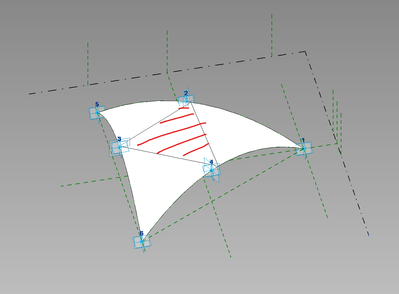

Hello everyone
I have this complex curve where it should be consist of 3 non parallel edge curves , but when I do a form , it creates it from 2 curves only and refuses to make the 3rd edge as a curve not a line
can anyone please help

You might want to look into Adaptive Families.
https://help.autodesk.com/view/RVT/2022/ENU/?guid=GUID-6E0ECA27-AF40-4B1D-9E0B-1DE5FBBD45F2
That's probably what I'd use here.  There's a bunch of video tutorials on-line you can watch to learn more. I've included a couple of links here to get you started.
https://www.youtube.com/watch?v=dPZz3RVvlR0&t=391s
https://www.youtube.com/watch?v=LKEbOAPMKdM

Thank you very much , it worked that way

Would you please share the family you did  @barthbradley
because it made a planer triangular surface here

Try 9 APs.
