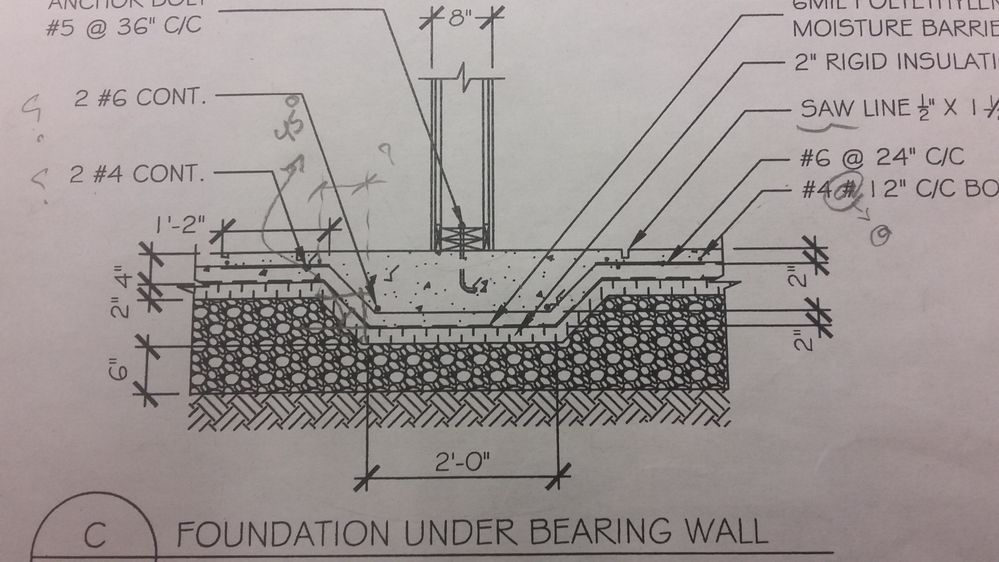

I have a bit of an interesting situation and I'm not sure if it's a quirk of Revit or if I am doing something wrong.
The situation is as follows, I have a wall and a slab in a monolithic pour that has been called out. My wall is anchor bolted into my slab and the walls foundation was pour as one piece with the slab.   If I use a cut plane I can adjust the slab in order to make a hump-like foundation on top of the slab and edit it, however trying to do the same thing with the bottom of the slab does not show anything. I have adjusted the view ranges and cut planes but to no avail.
Attached is a photo of what I am trying to achieve as a final product.
If it is not possible to do, what work-arounds can be done to achieve this?
Thanks in advance

You can simply create an in-place foundation with a sweep and join it to the slab.

Awesome, Thanks for the help
