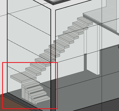

Hello, everyone
I would like to ask a question about the modeling of stairs. It starts embedded in the wall until their intermediate landing. The other steps are structured on the floor. In the photo I only made walls that simulate the continuation of the step on the floor, is there a more correct way to do it?

You can add carriege support on one side to the lower run of the floor. Edit depth of the support type so that it extends to the floor.
