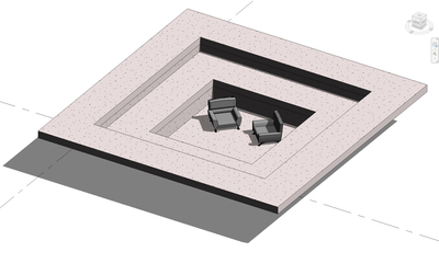

I have multi levels in the same floor, and some steps in deferent places also in the same floor, Adding to an irregular stair, should i make for each one level and indivitual floor or there is another way?

Can you provide screenshot what you want to achieve? Also having multiple level in the same elevation will introduce confusion. I would recommend you delete the level or move the level to other height.

sounds like riser heights would need to vary, which you couldn't do with a single stair. Additional levels won't help in this scenario. You need a separate stair for each run.
...out of curiosity, what is the offset height between these floors that are on the same level?
...something like this? If so, I wouldn't use stairs at all in this scenario.
