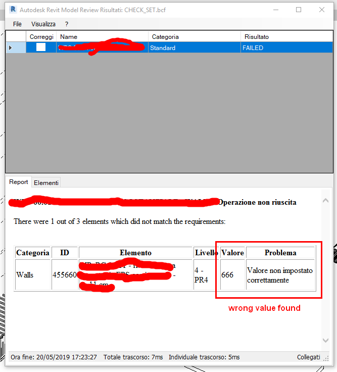

I'm having some troubles with the Model Review Add-In. I'm setting up a set of checks but I can't manage to make them work on linked documents. I've got a test parameter on walls instances that I need to check if is defined. The rule works as expected if I perform the check in the rvt containing the walls but if I link that file into another and specify "current model and links" before performing I get no result.
What am I missing?
that's the check on the rvt containing the walls
and that's the check on the file with the rvt linked
