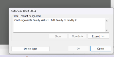

I've been trying to model different claddings on a building elevation, I've done multiple walls using the model in place method but it isnt working on one irregular shaped wall. can anyone offer up a solution for this problem?

I'm having the same issues. Is it something to do with Revit 2023? I didn't have these issues before!

I've managed to resolve it. For some reason the dissociate workplane function comes set differently. If you click on that your family should work. Hope it helps.

Have you tried using attaching the wall to floor and roof instead of edit profile?
