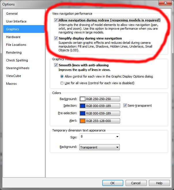

When you orbit the view without any selection, you orbit around the center point of the model extent. If it is far away from your building then you get what you described. The easiest way to deal with this without reduce the model extent is select an element of your building then activate the orbit command. Now the view will be orbiting around the element center point, thus eliminates your issue.

Yes I have checked those graphic options and they are already ticked.

als Antwort auf: chrisplyler
How do i get to this option menu
Nachricht 12 von 14
chrisplyler
als Antwort auf: Anonymous
Open the File menu. Towards the bottom-right of it, there is a button labeled Options. Click on it.
