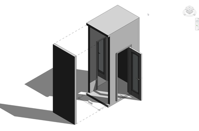

Hi all,
I am trying to find the way how to model an Air Shower for clean room, which has:
- a door;
- a "tunnel" (1000mm long);
- a door.
How can I put 2 doors in a family with a 1000mm ofset?
(The taken screenshot shows a family (with 1 door and a tunnel), This family is imprted into the Project. Second wall is added to form an Air Shower. Then it is all grouped together. The problem starts when I want to copy (and rotate) this group to another wall...

Why can't you just put two doors on two system family walls (offset from each other by 1000mm) in the project environment?  Too easy? :zwinkerndes_Gesicht:
...walls, floors, doors grouped together:
...and multiple copies of group placed and rotated about:  AirDoor2.png

Thank you for your reply. The example you made looks really nice, and I was able to do the same. However - as soon as I move from presentation example to my Project model, problems arise:
I can copy the group to another free place, but I get the warning "Insert conflicts with joined Wall.". The group gets copied, but one door remains highlighted (see attachment1).Attachment1.png
The same warning for copying in y direction (see attachement2).
When I try to copy the group to some other wall - I get the warning "Insert conflicts with joined Wall." and nothing gets copied (there is no attachment as nothing is visible).
When I try to "Create similar", I get the warning "Highlighted walls overlap. One of them may be ignored when Revit finds room boundaries. Use Cut Geometry to embed one wall within the other, or tab-select one of the grouped overlapping walls and exclude it from the group instance."
I can ungroup and delete the example wall I created, but the door is deleted along. I can delete the wall that was there in the first place, ungroup "Air Shower", adopt the wall's length to be the same as the deleted wall, adjust the height, replicate the other things that was deleted with the original wall, recreate the rooms...
But - can we call this a solution? Did you try to put your air shower to some existing wall? What was your procedure?

That warning is because the door family, overall, is slightly wider than the available space between the perpendicular walls. That means the door is sticking into the side walls enough that Revit thinks it should warn you it isn't likely to work in real life.
That's easily resolved by increasing the width slightly or modifying the door family so there is a more accurate representation for the frame/trim that your door design might really use.

- Draw walls with Disallow Join (or if you already drew them, right click at each wall end and Disallow Join for all 4 walls)
- Place doors
- Use Join geometry to Join the wall manually

@SteveKStafford
Yes, you are right. As soon as I enlarged the distance between the walls (without doors) - there was no warning anymore.
@ToanDN
Thanks, this solution enabled to "override" too tight walls next to doors.
@anze.kumar
Yes, that was the reason for warnings.
@barthbradley
So after all - your solution was applicable, I had other issues that gave me warnings. It needed a few additional steps, but it is applicable.

As for others who might have the similar issue, a quick (?) workflow, what I ended up doing:
- make 4 walls at appropriate distance;
- make the ceiling;
- add 2 doors (if the room is too tight, follow @ToanDN's instructions and disallow join);
- make group of all elements;
move the "insertion point" of a group to the "front" of the wall;
- rotate the group if needed;
- "create similar" and select the wall to insert the group - "Highlighted walls overlap. One of them may be ignored when Revit finds room boundaries. Use Cut Geometry to embed one wall within the other, or tab-select one of the grouped overlapping walls and exclude it from the group instance." warning arise.
- ungroup (if I don't ungroup, a funny thing happens)
- use Modify/Cut Geometry (as the warning implies) and select the smaller wall from the (ungrouped) group then the wall the group is put on - this removes the "double" wall, yet the door stays on the new wall.
Group is available for additional use from the Project Browser.
A smooth, optimized workflow? Well - it get's the work done...
