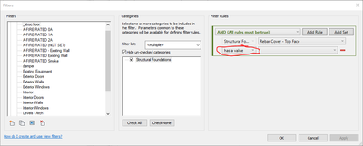

Hi everybody,
quick qestion.
I create a plate (structural foundation) in Revit. The plate should be load bearing, so I click on the plate and activatte the checkbox at "structural"
Now I want to create a filter for all plates which are set to "structural"
I make a new filter for category structural foundation. Now its not possible to search for "structural" in Filter Rules. I can only search for "Strucural Usage" (Bearing or Retaning). But I can´t find this Parameters in my plate.
Is it not possible to filter just for "structural"?

sorry for all the updated.... use one of the Rebar Cover options. and set it to Has a Value. if the structural checkbox is Unchecked there will be no value.

Yes an no I think.
With this way you can filter for every slab which is structural, thats true.
But the other way around does not function. If you set it to "has no value" you should filter for alle instances where the checkbox is unchecked. But this does not work.

ok... how about this....
use Does Not Contain and set the parameter to " (or better yet use the < symbol)

Yes! Thats it!
Thank you very much!
