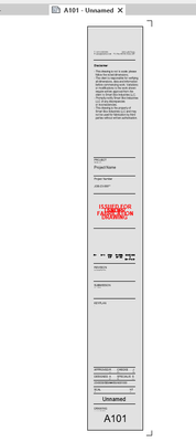

Hi...
I created a title block in Revit. but when I am loading it into any project, items are missing (horizontal line, company logo, etc.) Please see the attached image files. Where am I going wrong? I have attached the title block family also
18 ANTWORTEN 18
Nachricht 2 von 19
syman2000
als Antwort auf: Shamseera.kk73D7Q
Solid fill in titleblock will always display as masking and hide the line. One way to get around this is to insert solid fill image.

Shamseera.kk73D7Q
als Antwort auf: ToanDN
I tried this. but still, the company logo is missing. also while converting it into a pdf I'm not getting it in full A3 sheet.
Nachricht 5 von 19
Shamseera.kk73D7Q
als Antwort auf: syman2000
Hi..
This image option worked. Thank you. But when Im converting it to pdf, I'm not getting it in a full A3 sheet. Please see the image.
Nachricht 6 von 19
syman2000
The extension of the reference line may cause the print to stretch beyond the A3. Try to stretch it closer to the boundary of the titleblock.
