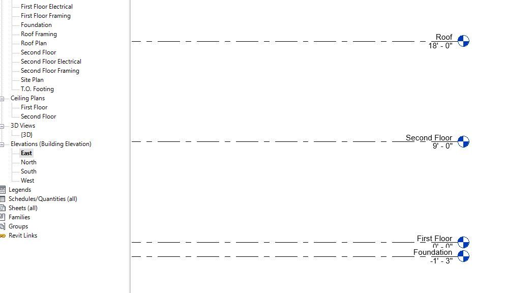

After watching many replies to similar issues I am posting this query.
New to Revit (40 years with Acad and INV). The images shown are from the canned file that comes with Revit 2022.
Residential_Default.rte
The east elevation shows only some of the level lines that are shown in the West elevation.
No cropping is turned on anywhere.
Plan flags set to cropping.
Reset everything to 3d extents.
I have added no geometry of any kind. The is a new file.
Why are level lines missing in East Elevation?
2,594 Views
You don't see those levels on East Elevation because they are outside of the Far Clip distance.
Select all levels, right click and Maximize 3D Extent.  Or set East Elevation's Far Clipping to No Clip.
I've done all of that. No change. Far Clipping = none, etc.
If you have the time open the new>Residential_Default.rte (2022) and see if you can make them visible.
I see.  They were hidden in View.  Turn on Reveal Hidden elements lightbulb, select the pink levels, right click and Unhide in View, then turn off the lightbulb.
I wasn't expecting a factory OOTB template with elements being hidden in View manually.  Not the best practice.
That my friend made my day. Thank you for your time.
