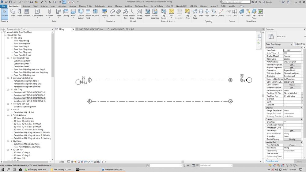

Can I ask you guys? in the foundation I lost some axes from 1 to 5 (the ground floor is there), the vertical AB shows all levels, and the vertical 1-6 do not show levels 1-6, I have entered VG and reveal hidden element, the grid and level are still on, asking you to fix bugs!1.jpg2.jpg3.jpg4.jpg

Select a grid line, right click, select all in project, right click, maximize 3d extent.
